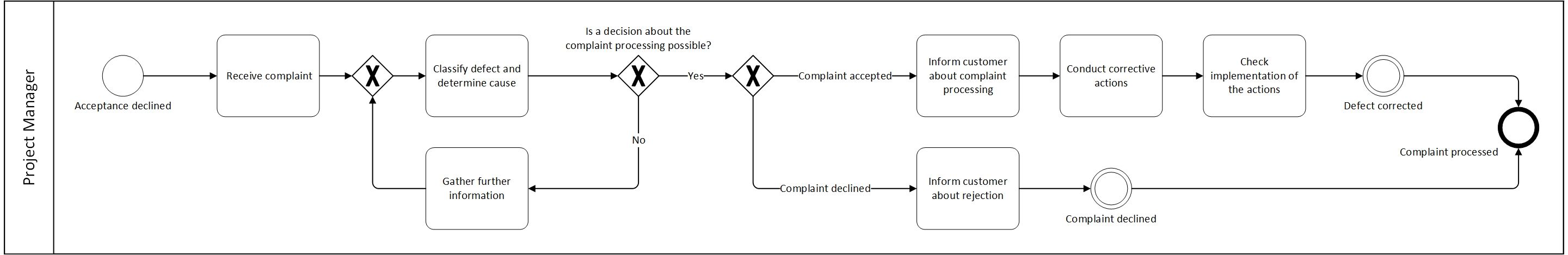

The complaints process represents the standard handling of customer complaints. It begins with the receipt of a complaint. The end of this process is marked by the complete processing of the complaint or the rejection of the complaint.
Furthermore, the standard handling of errors, which are recognized  by a project employee of ARTS Solutions GmbH after the final technical acceptance, is considered.
The aim is the customer-oriented processing of complaints in connection with services.
1. Receive complaint
  • Responsibility: Project Manager
  • Complaints about the work result are sent by the customer in writing to the project manager or communicated verbally at the project acceptance.
  • In the case of an error recognized by an employee, the first process step is omitted and the complaint is to be understood as a description of the error by the responsible employee.
  • The form of the 8D report serves as a document to describe the error and is communicated to the responsible project manager.
2. Classify defect and determine root cause
  • Based on the complaint and the project documentation, the defect is classified and the cause of the defect is determined.
  • If it is an internally recognized error, the customer will be informed of the potential error and the evaluation will be included.
3. Gather further information
  • If there is not enough information available to make a further decision about a defect, the customer will be contacted to obtain additional information.
  • Then the deficiency is re-classified and the cause is determined.
4. Inform customer about complaint processing
  • If the complaint is accepted, the customer will be informed that his complaint has been processed.
5. Conduct corrective actions
  • If customer complaints are accepted, corrective measures are identified and carried out by the responsible employees in the project.
6. Check implementation of actions
  • Before completing the complaint process, the correct execution or implementation of the corrective measures is checked. Furthermore, these are added to the project documentation.
7. Inform customer about rejection
  • If the complaint is rejected, the customer will be informed in writing of the rejection and its reasons. The complaint process is then ended.
  • Reasons for a rejection include
    • The cause of the defect lies with the customer himself
    • The cause of the defect lies in downstream processes (not carried out by ARTS Solutions)
