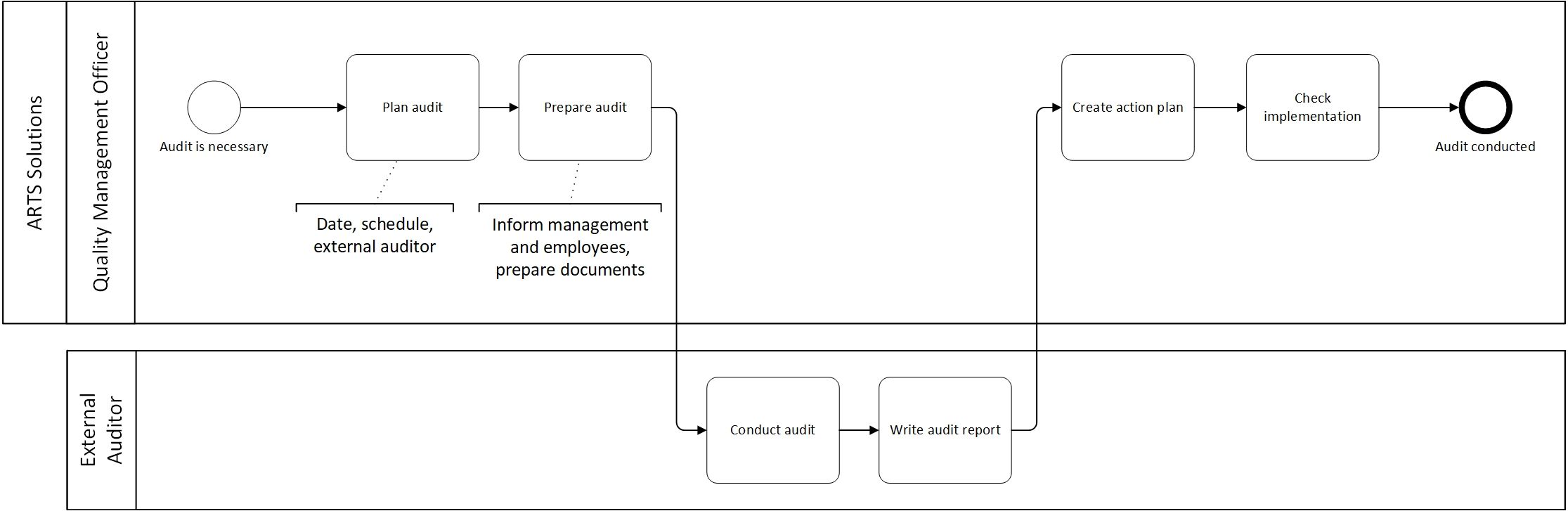

Audit process
Auditor
QMB
Management
Audit requirement
Fixed audit findings.
Improved QM system
Number of audit
findings Resolved audit findings within 4 weeks
The audit process represents the standard procedure for carrying out an audit. It begins with the internal or external necessity of an audit. The end of this process is marked by the completion of the audit.
The effectiveness of the quality management system is checked through audits. The maintenance, improvement and adaptation of this system to new internal and external circumstances and requirements are ensured. This review takes place internally, by suppliers and a certification body.
1. Audit plan
Responsibility: Quality Management Officer
Once a year, all processes included in the QM system are checked by an internal audit with regard to their significance for the quality management system and the effectiveness of the applicable requirements of the applicable standard.
An external auditor with adequate professional qualifications is commissioned to carry out the internal audits and carries out the audit in cooperation with the QMB. The date and the course of the audit are agreed with him and the management and employees are informed in advance. The performance is to be specified as follows:
Planning with an audit plan based on the audit plan template or a comparable template from the auditor
Carrying out the audit using a specified questionnaire agreed with the QMB based on the questionnaire template
Provision of an audit report
Planning and implementation of the audit in accordance with the requirements of DIN EN 9100 and DIN EN ISO 19011
Several years of experience in the certified area and in conducting audits
In the case of external audits, an agreement is made with the respective auditor. In particular, the certification and recertification audits by TÜV Süd must be observed.
2. Prepare audit
Responsibility: Quality Management Officer and department manager
The documentation and implementation of the quality management system is checked against the requirements of the applicable standard. The questionnaire can be used for this purpose.
In addition, all process, work and test instructions as well as technical and legal regulations (specifications, standards, ordinances, etc.) valid for the area to be audited as well as the requirements and expectations resulting from the context of the company are used as a basis.
3. Conduct audit
Responsibility: External Auditor and Quality Management Officer
Audits are carried out on the scheduled dates by the designated auditor.
The basis here are
the quality management manual
the relevant process, work and test instructions
all other quality-relevant working documents
the implementation documents
The respondents' statements are checked for traceability (presentation of documented information). Evidence can be provided, depending on the process, in the form of written documents, checklists, visual inspections or confirmation from several independently interviewed employees.
If a statement cannot be understood, this represents a discrepancy. The discrepancies identified are to be explained as specifically as possible using an example.
The questionnaire for internal audits serves as the basis for this. The audit report is also created on this basis.
4. Write audit report
An audit report is created by the auditor after each audit is carried out.
The audit report will be distributed to
the process owners
The Board
5. Create action plan
When discrepancies are identified, corrective measures are recorded in an action plan with dates, responsibilities, the degree of fulfillment and the review of effectiveness by the process owner.
The action plan is made available to all audit participants and affected areas.
6. Check implementation
Responsibility: Quality Management Officer / External Auditor
The quality management officer monitors the action plan for its fulfillment. Checks of effectiveness are carried out by the external auditor after 4 weeks at the earliest.
