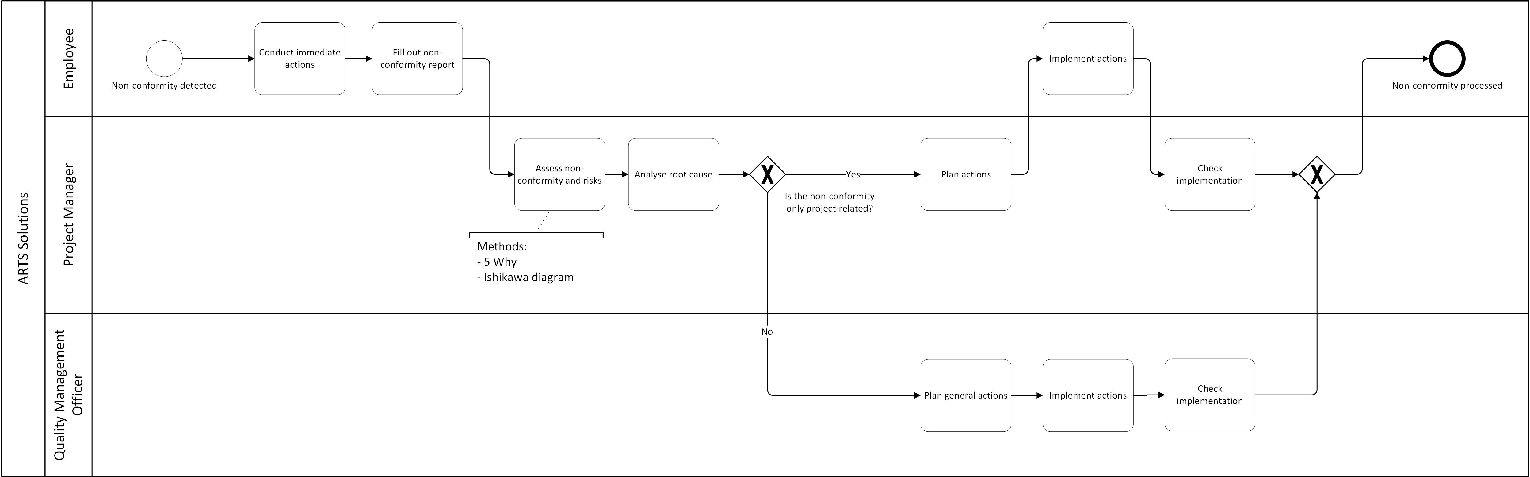

The non-conformity process represents the standard handling of non-conforming process results and services. It begins with the determination of a non-conformity. The end of this process is marked by the complete processing of the non-conformity through the implementation of measures.
The aim is to optimize the procedures and processes at ARTS and to provide feedback to the customer on potential for improvement.
1. Conduct immediate actions
                  Responsibility: Employee
                  If a non-conformity is found, the responsible employee can immediately take effective countermeasures independently.
2. Fill out non-conformity report
                  The non-conformity is documented using the 8D report or a customer-specific non-conformity report. This is forwarded to the responsible project manager and the quality management officer.
                  3. Assess non-conformity and risks
                  Responsibility: Project Manager
                  On the basis of the information from the 8D report or non-conformity report, the non-conformity and the resulting risks are assessed in consultation with the responsible employee and the QMB.
                  4. Root cause analysis
                  The cause of the non-conformity is determined in cooperation with the responsible employee.
                  Methods for determining the cause of the error are e.g. B.
                      5 Whys method
                      Ishikawa diagram
                  5. Plan actions
                  If the non-conformity is project-related, it will be processed further by the project manager. Actions are planned to correct the non-conforming performance.
                  6. Implement actions
                  Responsibility: Employee or Quality Management Officer
                  The planned measures are implemented and tracked via odoo.
7. Check implementation
                  Responsibility: Project Manager or Quality Management Officer
                  The implementation of the planned measures is checked and, if necessary, their effects are assessed. Based on this, a statement is made about the success of the measure.
8. General actions plan
                  Responsibility: Quality Management Officer
                  If a non-conformity is not only project-related, the QMB takes over the further processing. It defines measures to correct the non-conformity and assigns responsibilities.
